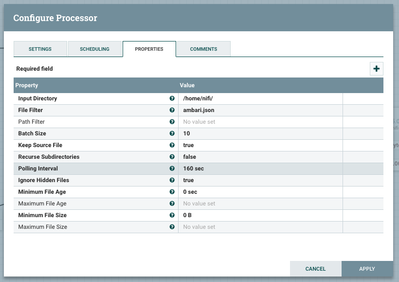

In My GetFile I've:

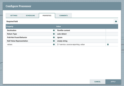

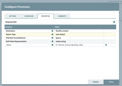

In the EvaluateJsonPath:
In the

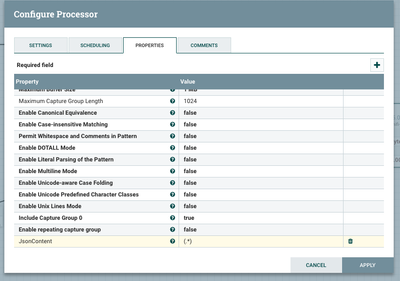

In the ExtractText

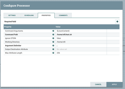

In the ExecuteStreamCommand:
And at the end, my putFile.
And here's the content of my shell script that Calculates each value from the value attribute and summarize to PutFile Processor.
#!/bin/bash
echo $@ | tr ',' '\n' | grep -o -E '[0-9]+' | paste -sd+ | b

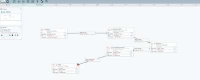

You can use the following flow:
GetFile > EvaluateJsonPath > ExecuteStreamCommand or ExecuteScriptCommand > PutFile
On EvaluateJsonPath you will add the attributes from your json content, follows attached my example.
Ps: In my case i'm getting all value attribute from my json file under the *.service..source.reporting.. path.
Hope this helps!
