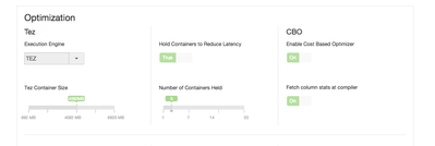

In recent HDP versions you don't have to explicitly enable it, it should be on by default already. You can check via Ambari -> Hive -> Configs. It will have the CBO switch like below:

@Andrew Grande, Thank you I saw that it was enabled in my settings
