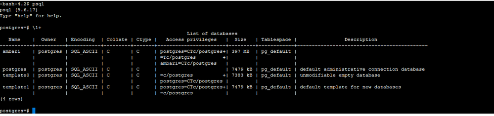

Contributor
could you confirm you can do queries on any database first and check ambari DB is restored
sudo -u postgres psql
\l+

Explorer
Yes I'm able to query the Database.Query ResultQuery Result
I tried with the following command
ambari-server setup --jdbc-db=postgres --jdbc-driver=/usr/share/java/postgresql-42.2.12.jar
Still ambari-server is not starting its giving the same error. Also tried rebooting the server also it didn't help.
