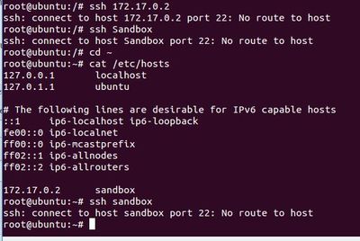

I enrolled in the HortonWorks University Practitioner - Partnerworks HDP Developer course for Hive and Pig.
I have downloaded the HDP2.3-Pig-Hive-Rev6.zip file for practice.
I followed all the instructions in the course, but am unable to log in to the sandbox.
Can someone please help me out??

I don't think I have access to the same course, but, all of the Sandbox verisons I have used have a different port for SSH access. Try using port 2222 instead and see if that works: ssh root@127.0.0.1 -p 2222

Thanks for you response! I had already tried that, to no avail.
I had to execute the recreate_sandbox.sh[in ~/.sys/ folder] script to be able to log into the sandbox.
Additionally, this VM is not the one that is available for free download.. so this is a bit different.
