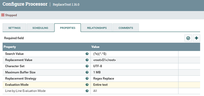

Im not sure this can be fixed by changing some configuration on what you have wither on the processor or the service level. Since the root element is not considered in the conversion from xml to Json, as workaround you can surround your xml with arbitrary root element with the ReplaceText Processor before the ConvertRecrod Processor:
  •   Search Value: (?s)(^.*$)
  •   Replacement Value: <root>$1</root>
  •   Evaluation Mode: Entire Text
 This will output the following xml:
<root>n<a>
<b>45</b>
</a>
n</root>
And After ConvertRecord Prceossor :
{"a": {"b":45}}
Hope that helps. If it does, please Accept Solution.
Thanks

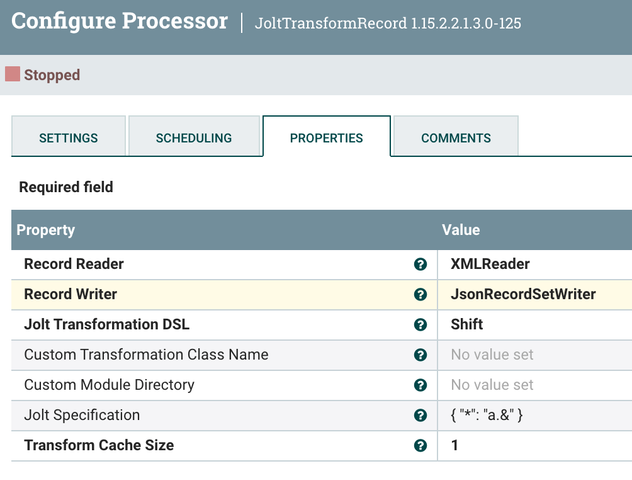

You can use a JoltTransformRecord processor to perform the conversion to JSON and, at the same time, add the root node back to it.
The JOLT specification I used is this:
"*": "a.&"

ChuckE
ChuckEAuthor
Gold ⭐️
Aug 3, 2022 5:41 AM UTC
This seems like a good idea.  I'll give this a try and test the performance against the XSLT transform.  I've never used the JOLT processors before so this will be a good opportunity to experiment with one.  Thanks for the idea.
