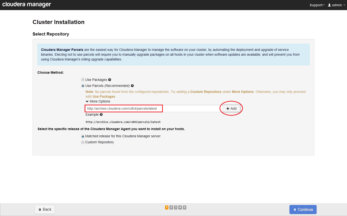

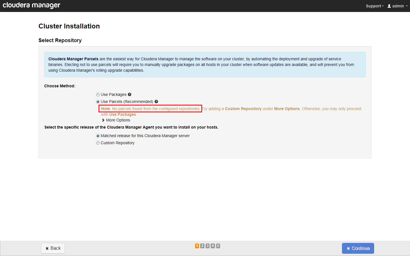

[Problem 1]
When i using Cloudera Manager to install CDH, during the 'Cluster Installation' step, i chosed 'Use Parcels'.
But there was no parcel choice, and the page noted 'No parcels found from the configured repositories.'.
Then i followed the notes, and tried to add a custom repository in the page: enter the correct URL for lastest CDH4, click button 'Add'. But i got no response.

Here are the screenshots for problem 1:
