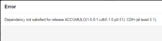

I am trying to activate my downloaded parcel of Accumulo from the Cloudera Manager for CDH 5.1.0
Cloudera Manger info:
Version: Cloudera Express 5.1.1 (#82 built by jenkins on 20140725-1608 git: cb9ebb729efc7929e1968b23dc6cf776086e20a7)
CDH
Version: 5.1.0
and I recieve the following error
Please help

version of CDH should be atleast CDH 5.1.0. Can you please verify that's
the case?

So I beleive I listed the version in my previous post; however, if there is perhaps a way for me to verify that beside through the CM
CDH
Version: 5.1.0

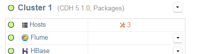

We usually see this error if the cluster is installed using "packages" instead of "parcels" - can you verify how CDH is installed? At this time, it is not possible to mix and match package and parcel installations.
You should be able to see that on the CM UI home page next to the cluster name. It will be something like "Cluster 1 (CDH 5.1.0, Packages)".
If your cluster turns out to be installed using packages, then you will need to follow the packages instructions in our Apache Accumulo Installation Guide, starting on page 10.
If it is installed using parcels, then we will investigate further.

Thats exactly the issue, Thank you! I will follow the steps outlined in the documentation.
