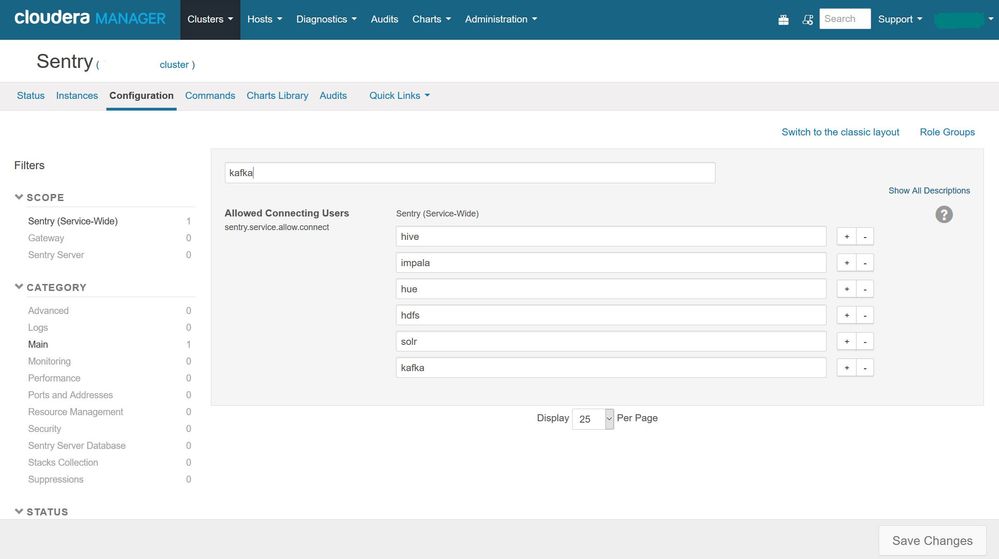

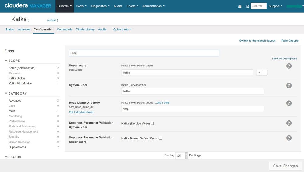

I've checked Sentry configuration and there is configured kafka user as one of service users in sentry.service.allow.connect setting.
kafka is local (not LDAP) user, that has the same uid and gid in Linux on every cluster node.

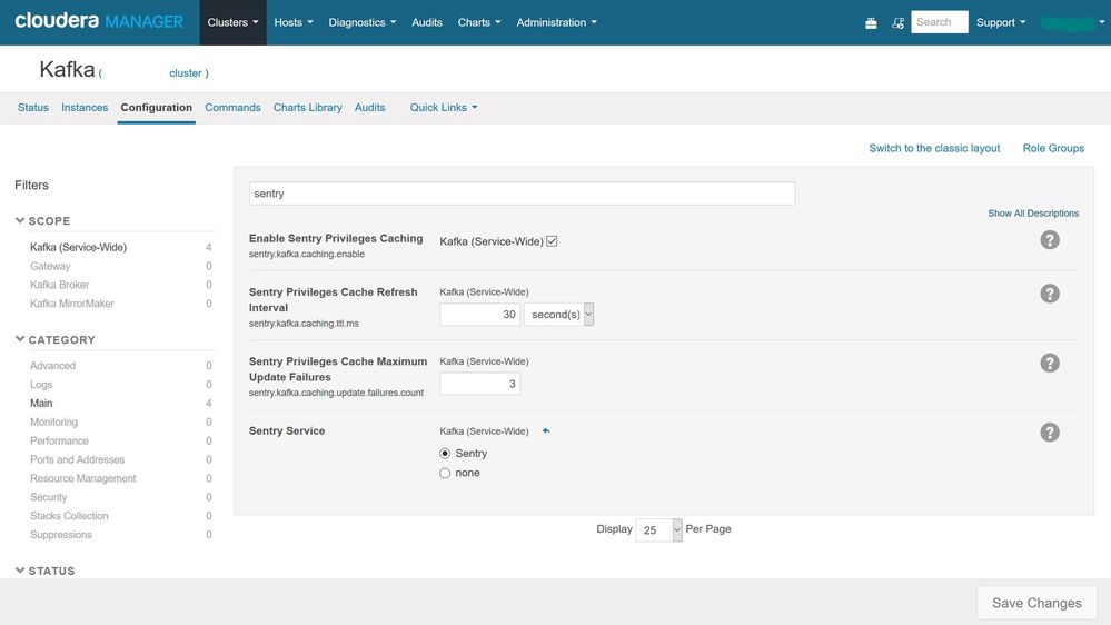

Well as far as I can read the code I've cited, there is problem when Kafka wants to list roles, and it want to do this when caching Sentry privileges is enabled.
When I:
1. In Kafka configuration disabled sentry.kafka.caching.enable
2. In Sentry configuration deleted kafka group from sentry.service.admin.group, so the configuration is:
root@node1:~# cd `ls -dt /var/run/cloudera-scm-agent/process/*sentry* | head -n1`
root@node1:/var/run/cloudera-scm-agent/process/1442-sentry-SENTRY_SERVER# grep -A 1 -E "sentry.service.(allow.connect|admin.group)" sentry-site.xml
    <name>sentry.service.admin.group</name>
    <value>hive,impala,hue,sudo</value>
    <name>sentry.service.allow.connect</name>
    <value>hive,impala,hue,hdfs,solr,kafka</value>
3. Depoly client configuration and restart dependant services
After this steps Kafka started properly, so turning off caching of Sentry privileges was a workaround for me to start Kafka without errors.

Confirmation of sentry.service.allow.connect setting:
root@node1:~# cd `ls -dt /var/run/cloudera-scm-agent/process/*sentry* | tail -n1`
root@node1:/var/run/cloudera-scm-agent/process/1365-sentry-SENTRY_SERVER# grep -A 1 sentry.service.allow.connect sentry-site.xml
Kafka configuration for sentry (in CM).
Kafka configuration - users (in CM).
Sentry configuration - sentry.service.allow.connect (in CM).
When I:

When I add kafka group to Sentry admin groups (sentry.service.admin.group) it looks like everything is working, but only from kerberos logged user kafka:
root@node2:~# klist
Ticket cache: FILE:/tmp/krb5cc_0
Default principal: kafka/node2@TEST.COM
Valid starting    Expires           Service principal
21/06/2017 17:16  22/06/2017 03:16  krbtgt/TEST.COM@TEST.COM
        renew until 28/06/2017 17:16
root@node2:~# kafka-sentry -lp -r myrole SLF4J: Class path contains multiple SLF4J bindings. SLF4J: Found binding in [jar:file:/opt/cloudera/parcels/KAFKA-2.1.1-1.2.1.1.p0.18/lib/kafka/libs/slf4j-log4j12-1.7.21.jar!/org/slf4j/impl/StaticLoggerBinder.class] SLF4J: Found binding in [jar:file:/opt/cloudera/parcels/KAFKA-2.1.1-1.2.1.1.p0.18/lib/kafka/libs/slf4j-log4j12-1.7.5.jar!/org/slf4j/impl/StaticLoggerBinder.class] SLF4J: See http://www.slf4j.org/codes.html#multiple_bindings for an explanation. SLF4J: Actual binding is of type [org.slf4j.impl.Log4jLoggerFactory] 17/06/21 17:31:46 WARN util.NativeCodeLoader: Unable to load native-hadoop library for your platform... using builtin-java classes where applicable root@node2:~#
