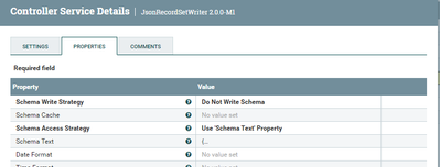

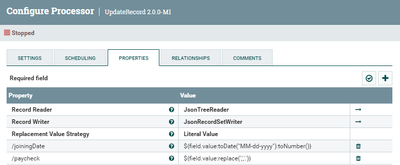

Another option is to use UpdateRecord to do the proper formatting, conversion for all attributes that require such thing and then just use basic shift spec to re arrange values accordingly. With UpdateRecord you need to use Avro Schema to define the proper types in the JsonRecordSetWriter.
UpdateRecord:
JsonRecordSetWriter:
AvroSchema in the Schema Text Property:
UpdateRecord:
