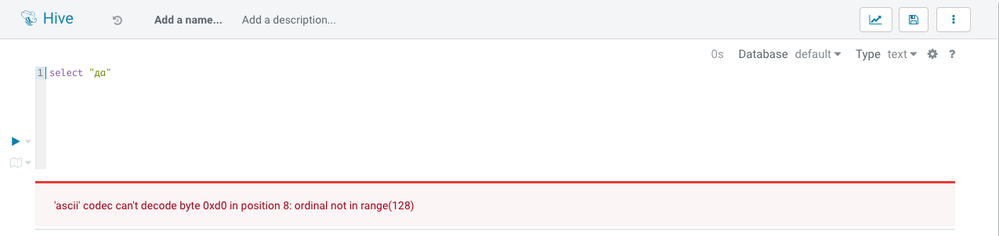

I try to run the SQL query to Hive in Hue Hive Editor, but get an error - "'ascii' codec can't decode byte 0xd0 in position 8: ordinal not in range(128)"

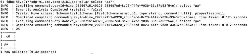

If I run the same SQL query in Hive CLI it's working.
This problem is in CDP 7.1.1.
Could someone help me?
P.S. Also, I have run the same SQL query in CDH 6.3.3 and it's working correctly.
P.P.S. I found ticket in Jira with the same issue, and it was was in 2016 - https://issues.cloudera.org/browse/HUE-3803

@nikolayburiak This may be due to encoding issue on HMS database. Can you try to change the format something like
alter table COLUMNS_V2 modify column COMMENT varchar(256) character set utf8;
Cheers!
