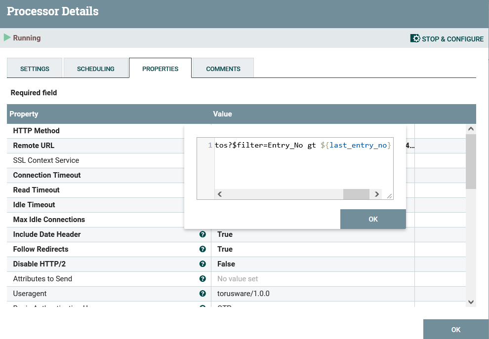

I have a flow where I make an HTTP request, and I save as an attribute the last ID value with EvaluateJsonPath and ExtractText processors. However, the InvokeHTTP processor doesn't read the saved attribute. What should I change?
I attach an image of this part of the flow. Thank you very much in advance. I'm stuck at this point and I don't know what else to try.

trying to understand your flow pipeline with respect to your use case explanations, You have two upstream queued for InvokeHTTP , in one  using ExtractText you are extracting text , which will be stored in flow file as an attribute then running HTTP Method from InvokeHTTP and configured Attributes to Send for the attributed which is created by ExtractText ?
What GenreateFlowFile os doing in this flow?  what evaluation is configured with EvaluateJsonPath ?

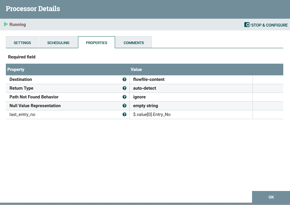

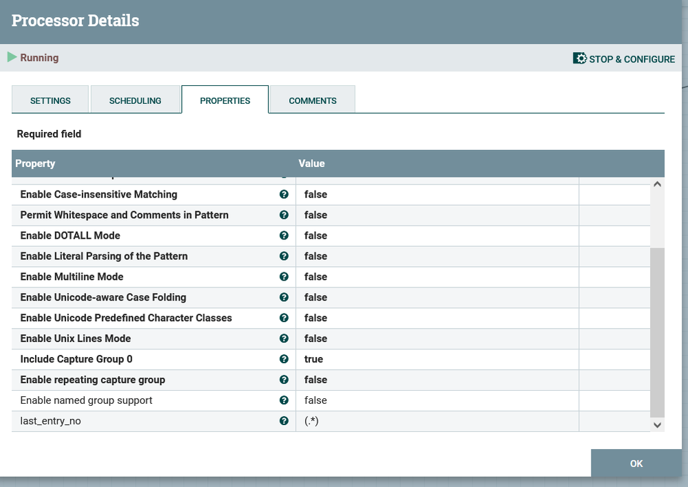

With InvokeHTTP, I make a request, which returns N rows in JSON format. To build this request I want to use the ID obtained in the previous request (separated by an interval of 5 minutes), because I need to get only new rows (with higher ID).  To do this, with EvaluateJsonPath I get the highest ID, which I call last_entry_no, and with ExtractText I try to do the mapping to the attribute.
Therefore, what I need is that InvokeHTTP reads the attribute that I tried to assign in ExtractText.

InvokeHTTP:
EvaluateJSONPath:
ExtractText:
