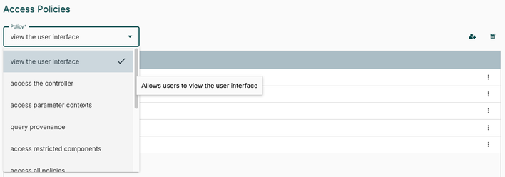

"Policies" will open a new UI, where you can select "view the user interface" fomr the drop down selection:
Then you can click on the person icon to the right to authorize additional user identities.
Your list of user will be different.  What is important to note is NiFi user and group identities are case sensitive and must match exactly.  So the exact user identity shown in the nifi-user.log is the one that needs to be added to the "view the user interface" policy.
