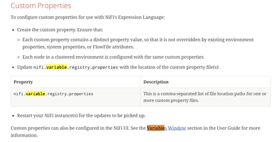

I don't know much of anything about Prometheus server, but if you can configure Prometheus to scrape from a unique port on each NiFi instance then you should be able use the variable registry to define a unique port number per host.  By using NiFi Expression Language (EL) you would still have matching flow.xmls on all your NiFi nodes.  You would simply have a unique variable registry file configured for each instance in that instance's nifi.properties file.
So for your nodes you would have three files:
<path to file>/node1-variables
<path to file>/node2-variables
<path to file>/node3-variables
In inside each of those files you would have the same property but each with unique value
PrometheusPort=9092  (written to node1-variables file)
PrometheusPort=9093  (written to node2-variables file)
PrometheusPort=9094  (written to node3-variables file)
Then when you start this reporting task, each node binds to a different port number.  Then you have your Prometheus server scrape from all three unique endpoints.

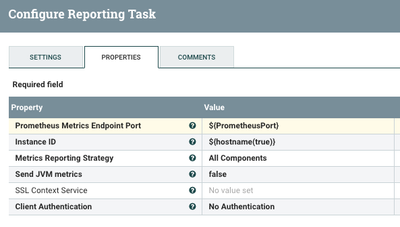

I tried the solution given by you that is to use variable registry and to use the variable defined there with EL in PrometheusReportingTask property as ${PrometheusPort}. But it is not evaluating it as an expression it shows the error that it's not an Integer and I got NumberFormatException in logs.
I think nifi-1.12.1 version just shows in the UI that this property support EL but actually it is not supporting.
I checked the source code as well in the git repo there as well, No evaluation is done for the Port property Expression ${}. Code is also expecting a hard-coded value.

Caused by: java.lang.NumberFormatException: For input string: "${PrometheusPort}"

Master Mentor
@kkau
Sorry to hear that the embedded documentation was not accurate for the port property.
I filed an apache jira to address that issue:
https://issues.apache.org/jira/browse/NIFI-8536
Best path forward is following NIFi recommended best practice where each NiFi node in your cluster is on a unique host.  This would allow each node to bind this reporting task to the same port.
Having multiple hosts on same server will present issue/challenges with any component (processor, controller service, reporting tasks, etc) that create a listener port.  While some may you may be able to work around with Variable Registry suggestion I shared, others like this use case will not.
