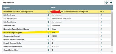

In NiFi (1.19.1) I set an ExecuteSQL processor, configured as follows: a simple DBCP Connection Pool pointing to my PostgreSQL Database, the simple select * from my_table as SQL select Query and !!! Use Avro Logical Types = true !!!
