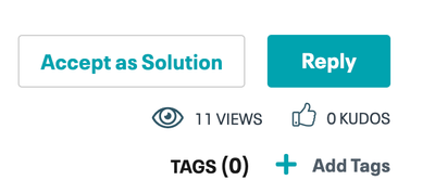

The version 1.16.2 works. I don't see an option to accept the soln.
Community Manager
Thanks for the confirmation @Althotta. You should be logged in to the community to see Accept as Solution option:
I have accepted @MattWho 's and @mnui's responses on your behalf. I hope that's alright with you.
