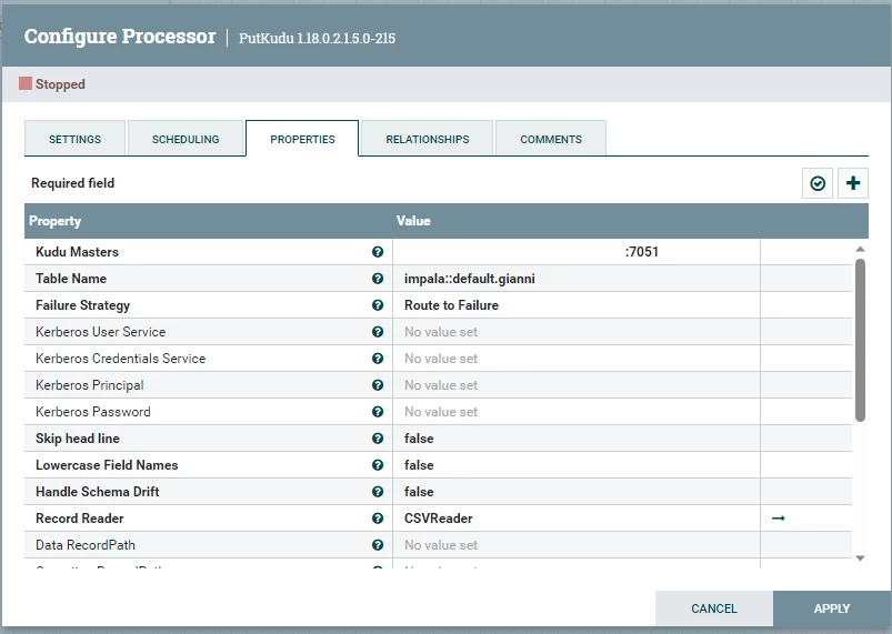

I am having troubles with the PutKudu processor.

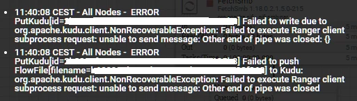

The Put Processor should write on a KUDU table, previously created by using Impala on HUE, inside the HDFS. Everything is configured but the PutKudu processor keeps showing up this error message. Kudu is configured with just one master (leader). I am thinking that this error could be caused by my one-node configuration as the docu seems to suggest to use a 3 nodes configuration at least. Is this the case ?
The error message is too generic to be useful for any kind of debugging activity.
The pipeline is composed by two processors: generateflowfile and putkudu.
Down below you can have a look at the error messages and at the putkudu properties.

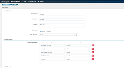

We are using default settings, so Kerberos is disabled, we are using Ranger with default service name and policies created by Cloudera manager installation.
As described in this post (https://community.cloudera.com/t5/Community-Articles/Using-the-PutKudu-processor-to-ingest-MySQL-data-into-Kudu/ta-p/247205) we thinks that isn't necessary to enable Kerberos to scout this feature. If kudu requires an authentication to work properly we accept to use Ranger, but for the moment we don't want to enable kerberos.

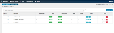

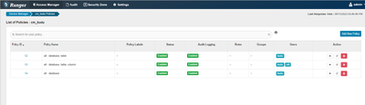

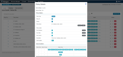

By using Impala on HUE we created a KUDU table. Then by Ranger webUI, in the Hadoop SQL service name created by cloudera manager during installation, I modified the "all - database, table, column" policy which allows access to all databases, tables, and columns, extending permission also to users "nifi" and "kudu".
And this is the cm_kudu policy in Ranger:

2023-09-11 17:23:39,283 ERROR org.apache.nifi.processors.kudu.PutKudu: [PutKudu[id=2b2950fe-0ea5-1659-0000-0000647695b8], StandardFlowFileRecord[uuid=be4462ec-77ab-4782-abc3-1cf4733c8666,claim=StandardContentClaim [resourceClaim=StandardResourceClaim[id=1694445816369-1, container=default, section=1], offset=0, length=17],offset=0,name=be4462ec-77ab-4782-abc3-1cf4733c8666,size=17]] Failed to push {} to Kudu
org.apache.kudu.client.NonRecoverableException: Failed to execute Ranger client subprocess request: unable to send message: Other end of pipe was closed
at org.apache.kudu.client.KuduException.transformException(KuduException.java:110)
at org.apache.kudu.client.KuduClient.joinAndHandleException(KuduClient.java:470)
at org.apache.kudu.client.KuduClient.openTable(KuduClient.java:288)
With kerberos disabled in the cluster and in each services, we don't understand why this debug trace is present in the log: "DEBUG org.apache.kudu.util.SecurityUtil: Could not login via JAAS. Using no credentials: Unable to obtain Principal Name for authentication"

Hello to all again. I think tath my issue is related to a missing authentication by ranger.
So, i follow the the Clouder guide instruction (https://docs.cloudera.com/cdp-private-cloud-base/7.1.8/kudu-security/topics/kudu-ranger-policies.html) about
Ranger policies for Kudu
I modified the service name cm_kudu as follow
and kudu policy as follow
i restart both kudu and ranger services.
But when i run the command, it give me an error
sudo -u nifi kudu table describe machine-bigdata-h02 default.gianni
End of file: Failed to execute Ranger client subprocess request: unable to send message: Other end of pipe was closed
