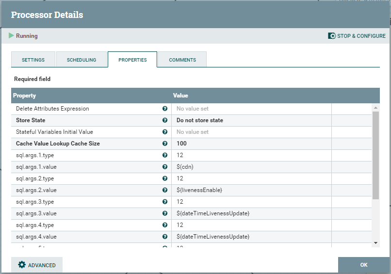

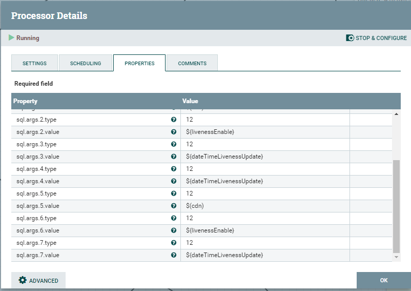

Mapping the parameters in a PG of type UpdateAttribute set as shown in the figure:

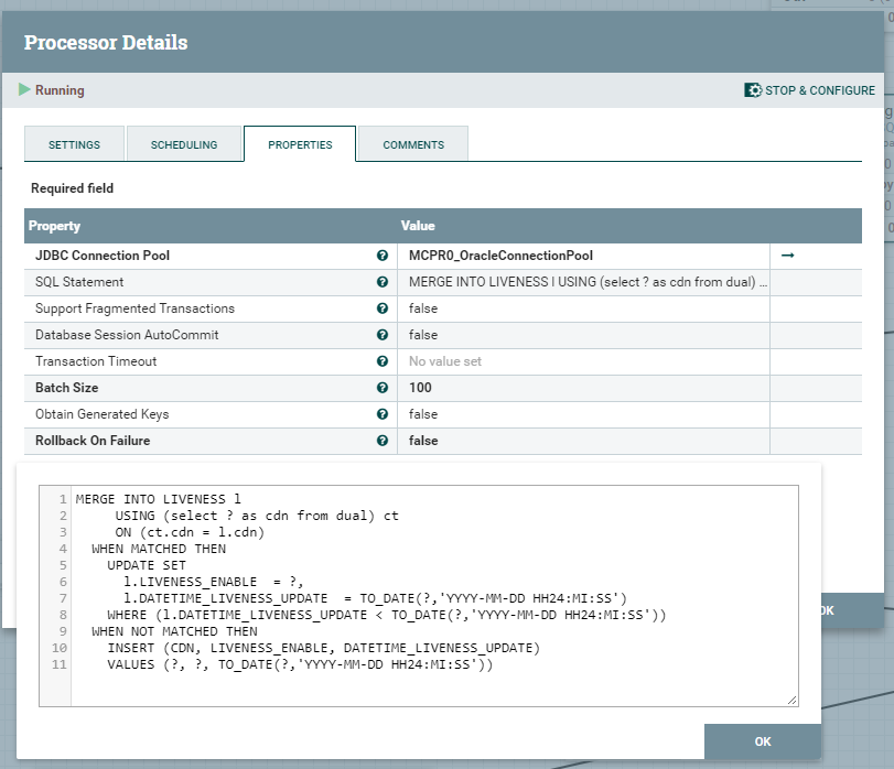

While as far as the PutSQL PG settings are concerned, they are as follows:
The problem is that even if the PG containing the MERGE returns a success, the modifications do not affect the DB on which NIFI points. Can anyone give me some more information ?

Hi,
I noticed you are using "$(cdn)" instead of "${cdn}" for sql.args1.value to probably reference the flow file attribute cdn which you are using as merge key. That is probably why the merge has no effect because its looking for the string "$(cdn)" instead of the attribute value "${cdn}".
