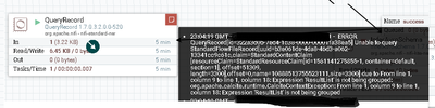

I have the following JSON Record in my incoming Flowfile to QueryRecord Processor and wanted specific fields from the content. I want Index, Sentiment and max(SentimentScore)

And the Query i use is;
select (ResultList, '/Index') as "index", (ResultList, '/Sentiment') as "sentiment", (ResultList, max('/SentimentScore')) as "score" from FLOWFILE
While Executing i get the following Error,
Can someone help me achieving this use case?
