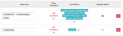

I am looking in the Kafka policies in my current Ranger Instance. There is a policy called "service_all - cluster".
When I look here are the two allow conditions for this policy -
However, when I run this API call to get all the policies for kafka and search for the "service_all - cluster" this is result -

Here you can see there are 3 extra accesses given called publish, consume, delete that aren't showing up in the user interface.
Yesterday I did a whole reimport of all the policies for Kafka and it fixed the issue but after a restart of ranger this happened again. I checked the underlying database and it's consistent with the User Interface but again the API call is adding those three extra accesses.
Does anyone know what happens after a restart that is causing the API call to differ from the User Interface?
