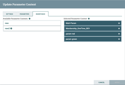

From the NiFi Global menu in the upper right corner, you can select "Parameter Contexts".  Use the "+" icon to add you various parameter contexts to your NiFi.
1. Add a new Process Group (PG) to the canvas.
2. Right click on that PG and select "configure" from displayed context menu.
3. Under "Process Group Parameter Context", select option to create new parameter context.
4. Give new parameter-context a name in the "Settings" tab and click apply.
5. Right click on PG and select "parameters" from displayed context menu.
6. Select the "inheritance" tab.  All available parameter context for which your user is authorized to access will be displayed to the left.  Start dragging and dropping the parameter context from which your want your new parameter context to inherit from to the right side. If multiple parameters with same name exist, the one from the parameter context furthest up the list on the right side will have it's value used.  If the new parameter context has its own defined parameters, they take precedence over those of same name in the inherited parameter contexts.
7. Click Apply.
You now have access to unique parameters from all the inherited Parameter Contexts.
When configuring a parameter context in a component property, type "#{" and then  hold "control key" while hitting "spacebar" to show full list of selectable parameters from all inherited parameter contexts.
