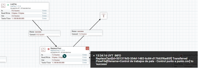

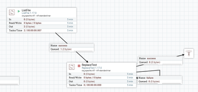

The flow looks like this    ListFile ---> ReplaceText (see image below)
ReplaceText has the following settings: Replacement Strategy = Always Replace, Replacement Value = id,description,date
At first I thougt that ReplaceText could fail cause incoming flowfile had no content.
But ReplaceText sent the flowfile to success BUT NO CONTENT WAS WRITTEN (It is still empty)
In the image below you can see that Queued Bytes are 0
Setting Bulletin Level to "DEBUG" just throws the following message : "ReplaceText[id=501319d3-354d-1482-6c84-d176639be85f] Transferred FlowFile[filename=Control de trabajos de pala - Control punto a punto.csv] to 'success'"

Hi @SAMSAL , thanks for your response. You are right, changing to "Entire Text" worked
I was in a hurry and didnt try changing the evaluation mode. I supposed that "Always Replace" would do the work.
