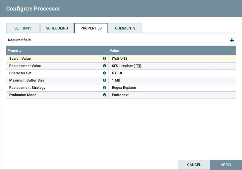

Super Guru
@ForrestGump I believe you are using ReplaceText.
I use it like this:

Super Guru
Notice my settings for All Properties and I use Regex.
If you don't want to use Regex, change Replacement Strategy.
I would recommend doing it as I have shown, with regex on complete flow file. Not line by line.  Also, you can append and prepend more text and transformations in same replace too. For Example:
PREPEND
${'$1':replace('"',''):replace(',',' '):replace('\n',',\n')}
APPEND

Super Guru
@ForrestGump  there must be some configuration difference then.   I created a simple flow and was able to get below output using exact proc I screen shot above on your Before data:
Year,Day,Hour,Minute,ID_for_SW_Plasma_spacecraft,Percent_of_interpolation,Timeshift,RMS_Timeshift,RMS_Min_var,Time_btwn_observation_sec,Field_magnutude_average_nT,BY_nT(GSM),BZ_nT_(GSM),RMS_SD_B_scalar_nT,RMS_SD_field_vector_nT,Speed_km/s,Alfven_mach_number,Magnetosonic_Mach_number,BSN_location_Xgse_Re,2019,1,0,0,51,100,2788,164,0.12,999999,5.11,2.00,2.73,0.08,1.03,451.0,9.8,6.5,13.15

I have dropped the template for you here:
https://github.com/steven-dfheinz/NiFi-Templates/blob/master/Replace_Text_Demo.xml
Contributor
Thanks for the effort @stevenmatison I imagine it does have to do with configuration.
