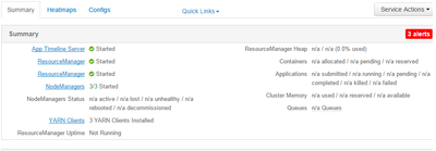

We enabled Yarn Resource Manager HA on our cluster ( HDP 2.3.2 and Ambari 2.1.2.1) and it was working fine until we re-installedRanger KMS server from the cluster. When the ResrouceManager HA was working, I saw one of them as active Resource Manager and the other one as Stand-by but they both are now showing as ResourceManager and also when I run the service check on yarn .. it is failing with the following error message

@Kuldeep Kulkarni I got the same error message. only difference is my env is kerborized & both my rm's are not in standby mode.
[yarn@m1 root]$ yarn rmadmin -getServiceState rm1
standby
[yarn@m1 root]$ yarn rmadmin -getServiceState rm2
active
Ambari doesn't show the state of RM, but getting same exception as above. i tried to switch the roles and that didnot help. Any help is appreciated.
