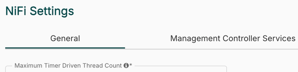

Note: Scheduling of a NiFi component does not mean immediate execution.   That execution depends on availability of threads to service the execution.   NiFi has a "max timer driven thread count" configuration that establishes the thread pool from which all scheduled component threads come from.
So things like number of running components, number of concurrent tasks set on a given component, CPU insensitive components, etc can impact when a "scheduled" component is given a thread from the thread pool to execute.
I Thread pool does not impact scheduler unless the processor has been scheduled and never executes until within the 1.5 hours since it was initially scheduled (which I doubt in this case).  The more logical cause because of the consistent behavior is the "retry" you have set on Success from ListSMB.
