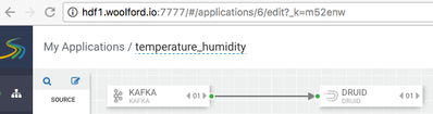

I created a minimal SAM application that reads Avro messages from Kafka and writes them to Druid:

When I run the topology, the following error is thrown:

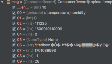

The first byte of the Avro inputstream appears to be a form-feed character (ASCII code 12):

I don't understand how the first byte of the Avro byte array could contain the ID for the schema registry unless it were created with a schema registry aware serializer.
