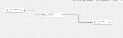

I am running a basic Kafka source and sink with one rule in between
both have different schemas and i am using a console consumer to read out the sink .
