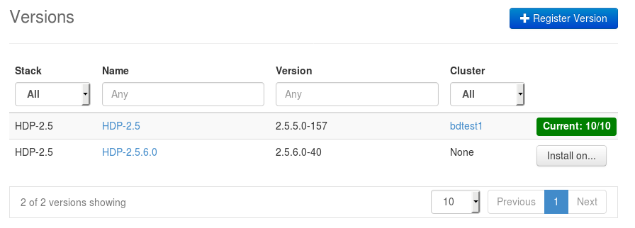

The first issue I encounter is an empty page when I want to check then current HDP stack version details :
However, the HDP 2.5.6.0 stack details show up without problem. This version was created by uploading HDP-2.5.6.0-40.xml :

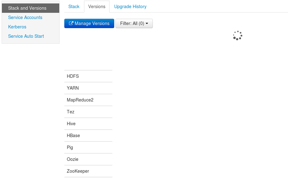

The second issue occures when I try to install the new stack version by using the « Intall on ... » button. I am then redirected to another page but nothing happends :
From here, I do not know where to look for possible troubleshooting and/or error messages. Nothing clear appears in Ambari nor system logs . I have searched for more info but was not able to solve those two issues (are they connected?).

I finally managed to solve this issue. It was due to the installed Ambari version not being available. repositories field of the repo_version table was empty for whatever reason.
To solve this issue, I downloaded and edited Version Definition File from Hortonworks then I added a fake Ambari version using the + Register Version button / HDP-2.5 / Add Version ... / Upload Version Definition File. I updated other fields to match the initial installation.
I then grabbed the repositories field from my custom Ambari version and updated the empty one with it. I restarted Ambari and voilà. The current version is now available and upgrade process does not hang anymore.
