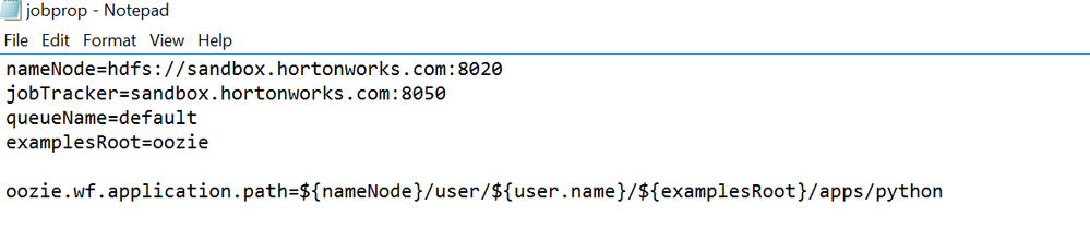

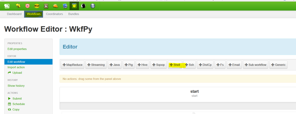

Hi @Artem Ervits and @Benjamin Leonhardi,
I am trying to execute a Python script using a Oozie workflow for the last two days with Hue->Workflows->Shell action, but I am getting a message 'Couldn't save the workflow'.
The script 'hello.py' is printing
print("Hello, World!") and placed under /user/oozie folder with all permissions.
My Shell action contains the attached workflow file.
The params are
hdfs://sandbox.hortonworks.com:8020
default
Job properties section, the property name is
'job-tracker' and the value is in the attached file(jobproperties.png)

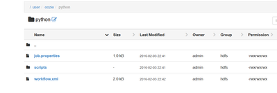

Sure, I am trying the same example now. I copied the files to the 'Oozie' folder on HDFS , screenshot 'files' ,
but encountered the error (screenshot attached) related to JVM. To start oozie i navigated to the folder
/usr/lib/oozie/bin/ and executed the script 'oozie-start.sh'
I am not sure if this is the correct way to execute the job. Any help would be greatly appreciated.
