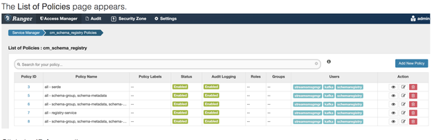

For pre-defined access policy controls access to one or more Schema Registry entities I need to add or enable the schema_registry ranger plugin. But I didn't configure how to enable or add in Service Manager for cm_schema_registy Policy List.
Here is the link to Cloudera documentation for schema registry in ranger service.
Schema registry security add-in ranger
for example:
As the documentation, ranger manage service seems like,

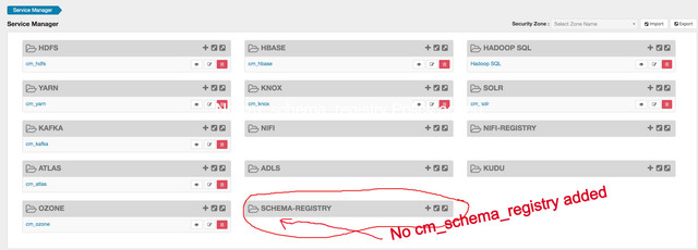

But in my ranger service manager, didn’t see the cm_schema_registry policy.
issue-screen-sort
So, my question is how to enable or add or user control schema registry from ranger service?

I have the same problem.
I believe there is a problem in the creation of the schemaregistry user, and the service.

Hi @sujonict07,
The process for creating the service along with it user should be automatic.
Have you tried unchecking the *Ranger Service* checkbox in Schema Registry?
Also, have you tried to run the Setup Ranger Plugin Service in Ranger actions?

Hello,
Every service should have the KRB5_CONFIG variable exported in its own safety valves.
As per the doc - https://community.cloudera.com/t5/Support-Questions/Kerberos-How-to-setup-Cloudera-Manager-in-order-...
  • Goto CM UI -> Schema Registry -> Configuration -> Service Environment Advanced Configuration Snippet (Safety Valve)
  • ADD key: KRB5_CONFIG value : /etc/custom-krb5.conf
  • Save and restart
