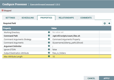

I have NiFi 1.23.2 running in cluster mode in K8s. As List SFTP does not take an incoming request have written a script that is called from ExecuteStreamCommand to count the number of files in a directory.
I am using expect to make this happen.

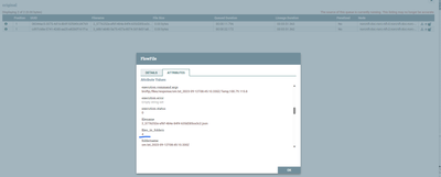

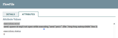

When I call the same script from NiFi processor I am getting
execution.error
send: spawn id exp3 not open while executing "send "yes\r"" (file "/tmp/tmp.eatmyc06B6" line 3)

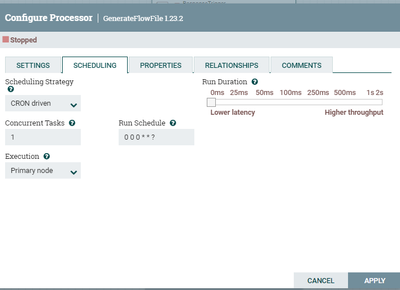

Rising Star
Turns out there is a workaround, there is an option to change the first processor to execute in single node, this will execute flowfiles from single node.
