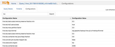

The property can be set on a per session basis I believe. The Ambari Tez View shows the query run, and if you click on the config tab, you can see the Tez properties for that query.
