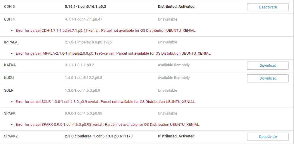

I see that you are on CDH 5.16. Spark 2.3 is compatible with that. What is the CM version you are on?
- Can you confirm if you have installed Spark 2.3 parcel in CM > Hosts > Parcels?
- Please post the directory permission for following:
ls -ltr /opt/cloudera/
ls -ltr /opt/cloudera/csd
- Can you confirm if you have installed Spark 2.3 parcel in CM > Hosts > Parcels? Send us the screenshot of the entire page if possible.
- Also please post the directory permission for following:

Details on permissions:
total 20
-rw-r--r-- 1 cloudera-scm cloudera-scm 19037 Jan 11 23:04 SPARK2_ON_YARN-2.3.0.cloudera4.jar
total 16
drw-r--r-- 2 cloudera-scm cloudera-scm 4096 Jan 11 23:04 csd
drwxr-xr-x 2 cloudera-scm cloudera-scm 4096 Jan 11 23:09 parcel-repo
drwxr-xr-x 2 root root 4096 Jan 11 23:09 parcel-cache
drwxr-xr-x 5 root root 4096 Jan 11 23:09 parcels

Created 01-11-2019 02:13 PM
1) The error that you showed talks about SPARK2_ON_YARN-2.3.0.cloudera2.jar not SPARK2_ON_YARN-2.3.0.cloudera4.jar. These are 2 different versions.
ERROR 1704117900@scm-web-7:com.cloudera.csd.components.C sdLocalRepository: Failed to load CSD from /opt/cloudera/csd/SPARK2_ON_YARN-2.3. 0.cloudera2.jar, Error: CSD bundle data directory or Jar file doesn't exist
2) Do you multiple CSDs in /opt/clodera/csd or parcels activated? If that's the case please deactovate other versions and delete all old CSD. Make sure the parcel and the CSD jar version matches.
