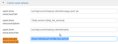

When I check the Spark History server I can see the following in the environment:
Spark properties:
system properties:

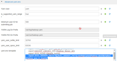

Furthermore in Ambari -> Yarn -> config -> Advanced yarn-env -> yarn-env template -> LD_LIBRARY_PATH:
Anything else I could do to make snappy available as a compression codec on YARN?

can you add the following parameters in spark conf and see if it works
  spark.executor.extraClassPath /usr/hdp/current/hadoop-client/lib/snappy-java-*.jar
  spark.executor.extraLibraryPath /usr/hdp/current/hadoop-client/native
  spark.executor.extraJavaOptions -Djava.library.path=/usr/hdp/current/hadoop-client/lib/native/lib
Super Collaborator
Thanks @Rajkumar Singh I have tried the mapred.child.java.opts and a few of the mapreduce settings suggested by @Jitendra Yadav but at the end just adding this spark.executor.extraLibraryPath would do the job.
New Member
spark.executor.extraLibraryPath did the job. Thanks! @David Tam and @Jitendra Yadav
