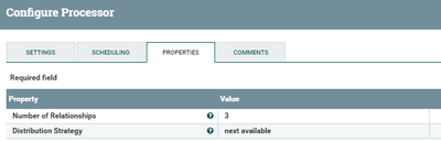

DistributeLoad Configs:
Number of Relationships1Determines the number of Relationships to which the load should be distributed
Distribution Strategyround robin
  • round robin
  • next available
  • load distribution service
Determines how the load will be distributed. If using Round Robin, will not distribute any FlowFiles unless all destinations can accept FlowFiles; when using Next Available, will distribute FlowFiles as long as at least 1 destination can accept FlowFiles.
As i have configured Number of Relationships to 3 then connected
  • 1 relationship from Distribute Load processor to first ConvertJsonToSql processor
  • 2 to second ConvertJsonToSql processor
  • 3 relationship to third ConvertJsonToSql processor
Based on the number of splits that you want change the configs in Distribute Load processor and add more ConvertJsonToSQL processor.
