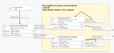

Thanks @Matt. Actually Jolt Transformation is the the solution worked for me (reached few days ago, I'm looking for time to write my answer 🙂 ).
In my flow I route on an attribute if I want the payload or not and then I apply this Jolt spec:
    "operation": "shift",
    "spec": {
      "headers": "headers",
      "info": "info",
      "payLoad": "payLoad"
    "operation": "default",
    "spec": {
      "_kafka": {
        "offset": "${kafka.offset}",
        "partition": "${kafka.partition}",
        "topic": "${kafka.topic}",
        "key": "${kafka.key}"
      "_nifi": {
        "flowfileuuid": "${uuid}"
Thanks to confirm this is the right way: I'm a newer to NiFi.
