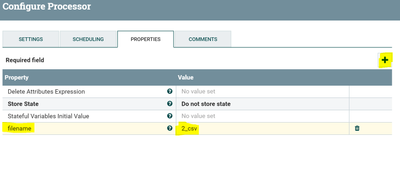

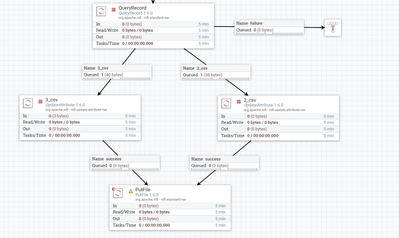

@Shailesh Bhaskar
Yes,by using update attribute processor we can change the filenames.
Flow:
As shown in the above screenshot use the 2 update attribute processors before PutFile processor and add new property in as
filename
2_csv
Same way add new property as
filename
3_csv
in 3_csv relationship feeding update attribute processor.
By changing the filenames like described above will keep filenames every time same.
For the first run there will be no issues because each file will have different filenames, but for the second run if you are not caring about the already stored file in the directory then use Conflict Resolution Strategy as Replace.
if you want to store all the files without any conflicts then use filename property values in update attribute processors as
2_csv_${UUID()}
and
3_csv_${UUID()}
UUID is unique number by using above expression language we are generating unique filename every time and there will be no conflicts.
Refernce flow.xml queryrecord-filenames-191697.xml
