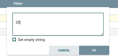

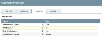

Currently, we have a setup where we are trying to group together events based on timestamp and split them based on timestamp in order to keep the stack trace error which have newlines in them.
We are currently using the SplitContent to split on: "(newline)
20"

Using "(newline) 20" allows us to maintain everything between the timestamps as an event, including the stack trace. Oddly enough it will produce in HDFS events with an extra blank line in between each event. (Not usually a big deal but with 2-3 GB files, we are seeing 100+ MB of just space for blank lines) Our current solution is to have ReplaceText processor that will remove all the blank lines but its obviously not optimal.
Any suggestions are welcome. Please see screenshots.

You are getting new line in each split because you stetted properties like that. Basically you are saying: Find me every (new line) 20 in flow and split it (Byte Sequence: (new line)20) and in each split add byte sequence (Keep Byte Sequence: true) which is (new line) 20 and finally add it to the beginning of the split (Byte Sequence Location: Leading).
You can split your flow with Byte Sequence: 20 (without new line).
