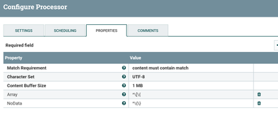

RouteOnContent Configs:-
Sample Flow:-
Like this way you can check the contents of flowfile is content having arrays or not.
for testing in the above example i'm just checking the starting characters of content, but you can check the whole contents of flowfiles by just adding new property with matching regex and change buffer size if needed.
