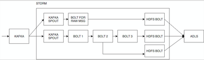

Hi all..We are noticing that there are some messages which get lost during storm processing..below is a brief outline of our pipeline.
We have messages coming to Kafka which then get consumed by 2 different kafka spouts in Storm. One Spout writes the message to raw stream and other storm starts processing the message. We need to store the output of Bolt2 to HDFS and also send it down for further processing which will then eventually end up in ADLS as well.
All the 3 HDFS bolts are configured to write to different folder structures in ADLS. In an ideal scenario I should see all the 3 messages in ADLS ( raw, out of bolt2 and output of bolt3). But we are noticing that raw gets written always but sometimes only one of the output (bolt2 or bolt3) gets written to ADLS. Its inconsistent on which one misses. Sometimes both get written. There aren't any errors/exceptions in log messages.
Did anyone run into such issues? Any insight will be appreciated. Are there any good monitoring tools other than Storm UI that gives insight into what is going on? We are using HDInsight and are hosted on Azure and are using Storm 1.0.1

@Laxmi Chary thanks for your question. Do you know if there's ever a case where Message from Bolt 2 doesn't get written but from Bolt 3 does get written? Are you anchoring tuples in your topology? collector.emit(tuple, new Field()) [the tuple is the anchor]
Are you doing any microbatching in your topology?

@Ambud SharmaYes. There is a case where the message from Bolt 2 doesn't get written but from bolt3 should get written. But if Bolt2 output is written, Bolt 3 output should always be there. vice versa is not true. Is that a problem?
We are not anchoring tuples. We are extending BaseBasicBolt and from I understand we need to anchor tuples only if we extend BaseRichBolt..Is that incorrect?
No, we are not doing any microbatching.

@Laxmi Chary
You should be anchoring, without anchoring Storm doesn't guarantee at least once semantics which means it's best effort.
Anchoring is a factor of your delivery semantics, you should be using BaseRichBolt, otherwise you don't have a collector.

@Ambud Sharma Doesn't the BaseBasicBolt do that for u?
New Member
This is what was mentioned in Storm Applied book
"The beauty of using BaseBasicBolt as our base class is that it automatically provides anchoring and acking for us." and we are using BaseBasicBolt. Are you saying that this is incorrect?
Expert Contributor
Yes, that is incorrect, https://github.com/apache/storm/blob/master/storm-core/src/jvm/org/apache/storm/topology/base/BaseBa... this bolt class doesn't even have a collector to acknowledge messages.
