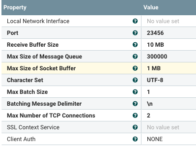

The flowfiles are small, about 5 KB each or less. ListenTCP processor is throwing these errors - "Internal queue at maximum capacity, could not queue event"; and messages are queuing on the source system side. Below are the memory settings for the ListenTCP that I set.

The single biggest performance improvement for ListenTCP will be increasing the "Max Batch Size" from 1 to something like 1000, or maybe even more. The reason is because it will drastically reduce the number of flow files produced by ListenTCP, which will drastically reduce the amount of I/O to the internal NiFi repositories.
The downside is you won't have a single message per flow file anymore so your validation needs to work differently. If you can change your custom processor to stream in a flow file, read each line, and only write out the validated lines to the output stream then it should work well. If the validation processor is still the bottleneck, you could increase the concurrent tasks of this processor slightly so that it keeps up with the batches coming out ListenTCP.
