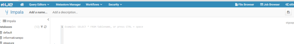

Access to tables is done via sentry, and all users can see correct databases in impala as per grant option but some users cannot see the same tables in Hive.

here is impala screenshot showing the databases. no databases appears in hive. Hue - Impala - Editor.png

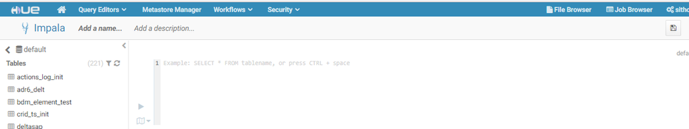

also in default using impala, i can see table but can't see them in Hivedefault impala.png

Logs from HUE and Hive would help. With screenshots, we can only guess what is happening.
In any case, you can check two things:
1) Check that Hive Server is running. This is not the case in my opinion because you should get an error in HUE. Just double check it. Impala connects to Hive Metastore, so it is not affected if Hive Server id down.
2) And most likely in my opinion, the users that cannot see databases, are not defined in the server where HiveServer is running. So Hive Server is not able to retrieve users' group and match it with a sentry rule. If you use LDAP/AD probably you have configured sssd (or equivalent) on each host. Check that this service is running and user info is fetched from LDAP/AD. If you have manually created users, then check that group info is correct.
