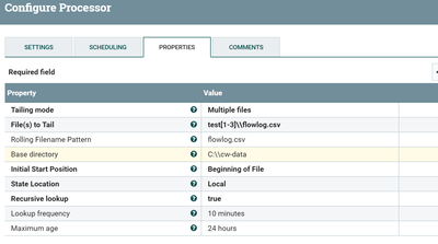

I have recreated your scenario and with the below configs i'm able to tail multiple files
Change the configs in your TailFile processor as keep two back slashes(\) on File(s) to Tail and Base directory property values
Tailing mode
Multiple files
File(s) to Tail
test[1-3]\flowlog.csv
Rolling Filename Pattern
flowlog.csv
Base directory
C:\cw-data
Initial Start Position
Beginning of File
State Location
Local
Recursive lookup
true
Lookup frequency
10 minutes
Maximum age
24 hours
If you are using linux the directory path will have forward slashes(/) will work without any issues but in windows directory path will have back slashes we need to keep two back slashes(\) to get correct directory path.
Tailing mode
Multiple files
File(s) to Tail
flowlog.csv
Base directory
C:\cw-data
Beginning of File
State Location
Local
Recursive lookup
true
Lookup frequency
10 minutes
Maximum age
24 hours
