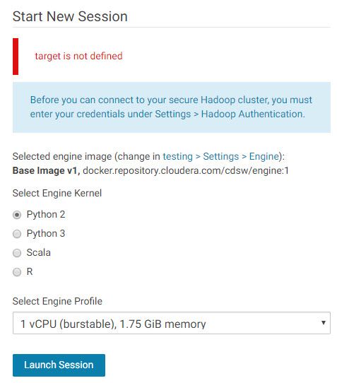

I try to start a new session to run any engine kernel, Python or Scala or R. There is a an error "target is not defined". i have run "cdsw validate" and there is no error. What target has not been defined and cause the error?

Have you set JAVA_HOME in your the Administration settings?  There is a known issue in 1.0.1 with custom JAVA_HOME directories that can lead to this error message.  A workaround is to remove JAVA_HOME from Admin > Engines and make sure Java is located at a location that can be detected by the bigtop-detect-javahome.sh script.  This will be fixed in a future release.
Please let us know if this workaround does not solve your issue or if this explanation does not match your configuration.

Hi Tristan,
The problem is solved by your suggestion. Thanks.
