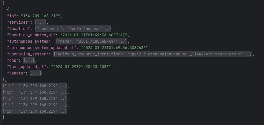

i'm using NIFI 1.22 and preparing NIFI flow for upgrade to 2.0.0 version.
Currently, using  PutElasticsearchHttpRecord in order to index flowfiles which contain array of nested jsons. This processor sends each flowfile as whole, does not require splits to single jsons or defining schema.
This processor is deprecated and it suggested to move to PutElasticsearchRecord.

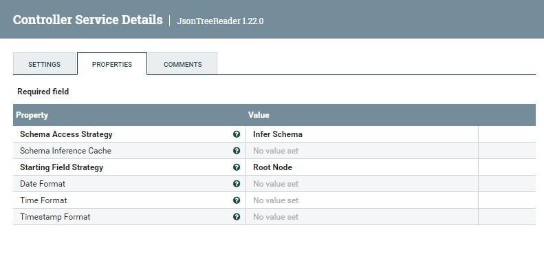

My data is very much complex and variant so I tried to avoid defining schema and to use  the Inffer Schema strategy of JsonTreeReader in  PutElasticsearchRecord.

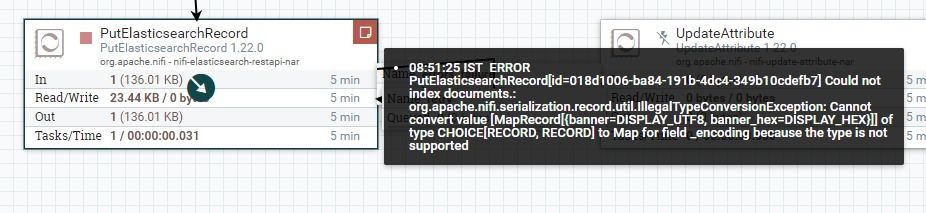

But the processor is failing on type conversion of the first field in the first json of the array. It seems that it cannot handle nested jsons in array (while splitting it to single jsons worked).

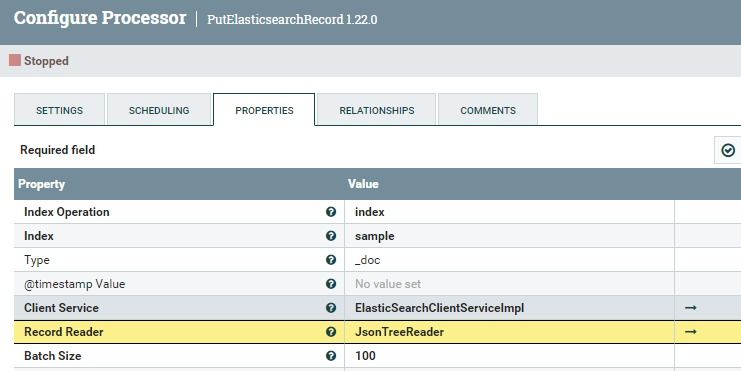

Adding more details about my flow configuration and example for the input filesputElasticsearchRecord_errorputElasticsearchRecord_errorputElasticsearchRecord_configputElasticsearchRecord_configjsonTreeReader_configjsonTreeReader_configinputFile smapleinputFile smaple

If "Infer Schema" isn't working this is likely a bug. Could you provide an example JSON and the error message that happens during schema inference?
