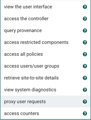

You will need to do one additional step once this new node has joined your cluster. Since the original clusters authorizations and users will not include this new node yet, you will need to access the cluster's UI from one of the original cluster nodes using and admin account and add the new node's DN as a user and then provide that new node with all the same access policies as the your existing node have. At a minimum you need to make sure your new node is granted the "Proxy user requests" access policy:
If you do not do this the following issues could occur:
1. You will not be able to access the cluster's UI via the newly added node (you will get untrusted proxy message)
2. You will still be able to access the UI via the other nodes as long as NiFi does not switch the cluster coordinator to your newly added node. You cannot restrict NiFi from picking any node in your cluster to serve this role.
