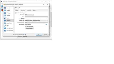

Hi, I did a lot of work on HDP 2.4 sandbox on VMWare Player and it worked like charm. I decided to download the HDP 2.5 (to check out the latest offerings) and that too the Virtualbox image and thats when all my troubles began . All hell breaks loose in acquiring an IP address for guest machine. Attached are screenshots for Network Options
and the final outcome when VM is up after around 10-15 minutes on my machine (i7 Dual Core, 16 Gb RAM) is that
127.0.0.1:8888 IP generated.
And putty fails to connect to this IP .

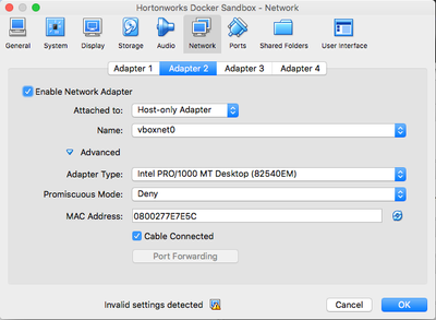

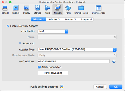

My VM instance has 2 network interfaces. The first interface is using NAT, which enables internet access. The second interface should be host-only adapter. This is the interface that provides the IP address you were likely expecting. The reason that 127.0.0.1 works is that VirtualBox is using port forwarding to pass requests on your computer from 2222 to 22 in the VM.
Here is a screenshot of my NAT interface:
Here is a screenshot of my host-only adapter.

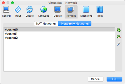

To get the IP address of the host-only adapter, you need to go to the main VirtualBox Preferences via the main menu. Click on the Network button. You should see something similar to this (you may have more or less host-only networks):

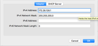

If your host-only adapter is on vboxnet0, then select that network and click the small screwdriver icon. Then you should see something similar to this:
You may have a different IP configuration. VirtualBox will typically give your VM the same address every time. However, I've noticed that sometimes it will bounce between 172.28.128.3 and 172.28.128.4.
