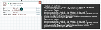

Hi @Ryan Cicak, I checked the metastore URI, it was not correct, so I fixed that, but now I'm getting a different error; no Kerberos on my setup; and our HDP is HA
This error is similar to what @Matt Burgess pointed to as an issue at onetime in the past - NIFI-2873, but that issue should be resolved in NiFi 1.1.0 and above; I am trying this in NiFi 1.1.2, but still same issue as pre-1.1.0
