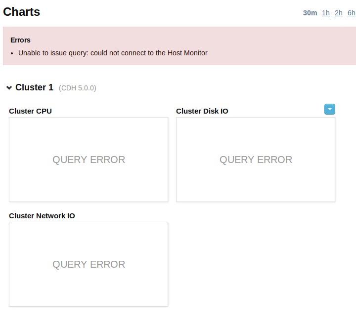

Hello, I installed the cloudera manager,then I install HDFS through cloudera manager. Wnen I want to see the cluster cpu, disk IO, Network IO status,  the problem occur.
How can I solve this problem,thank you

Does your Management Service exist? Does the Host Monitor Role in the Management Service exist? Is it started? Is there an error in the Host Monitor logs?
Normally the initial wizard in CM will guide you through setting up the Management service. Did you skip this wizard?

Thank you! yes, I do not install Management service, thank you

I do not install the Management service, after install it, I solved my problem. hope to help you

From the home page, there should be a button in the upper right of your screen to add the management service. It only appears if no management service exists.

I have added the Management service but it still see the error in charts:
"Unable to issue query: the Host Monitor is not running"
I even restarted the cluseter and all the services but still its not running.
Thanks
If you click on the Host Monitor and look at the role logs, stderr logs, and stdout logs, do they say why it failed to start?
