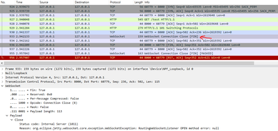

I have this error when I connect a websocket client (tried 3 different ones) :
2024-06-12 19:28:10,731 WARN [qtp293746312-1015] o.a.n.w.jetty.RoutingWebSocketListener Unhandled Error: Endpoint
org.apache.nifi.websocket.jetty.RoutingWebSocketListener : org.eclipse.jetty.websocket.api.exceptions.CloseException:
org.eclipse.jetty.websocket.core.exception.WebSocketException: RoutingWebSocketListener OPEN method error: null
I see connection successful on the client and then it gets disconnected immediately.
Client and server are on the same machine, url is ws://127.0.0.1:8000/test (or any hostname, port and path). I suspected a firewall issue but Python's websockets server is fine.
Thanks for your time.

More details about the platform : Windows, nifi 2.0.0-M3
Wireshark gives me that :

Tried on 2.0.0-M1, no problem. It looks there is a problem with Jetty v12 introduced at M2.
Until potential bug fix, additional conf or workaround, I consider downgrading to M1.
