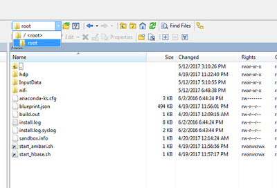

I am using Hortanworks Sandbox (HDP 2.6) on my Laptop Windows is OS on my Laptop.
I installed the NIFI at below path:
